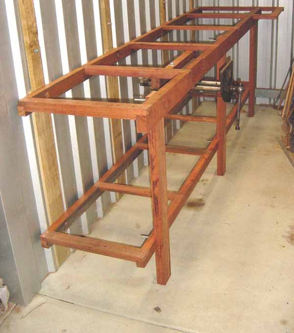

In a follow on from the "What did you do this weekend" thread, I thought I would share a few things I have just done when making a new bench just in case any of them prove helpful for anyone else just setting up. My bench is sturdy, reusable in a new location and environmentally friendly
The wall that the bench you see below is bolted to is an internally lined, insulated partition wall built within my shed which makes up part of the gluing and humidity controlled area I constructed a while back. The rough sawn 25mm CCA pine that you can see up against the sheeting acts as a caul sitting within the profile of the span-deck sheeting prevent it from being crushing as it spreads the clamping load of the bolts onto the "C" channel encased within the cavity of the wall sandwich.
This bench is 10' long and a little taller than normal (tall guy, bad back) and it is mirrored inside the glue room by another bench. Together, the two 600mm (2') wide benches with cavity wall shared between them make for one very, very sterdy structure and as most would appreciate, this also creates 20' of extra wall space for hanging stuff and shelving above the benches when done.
The benches are made of solid Jarrah. This wood was a local West Australian staple in the housing construction industry and it was known as Swan River Mahogany by early settlers. That name must relate only to the colour as this stuff is much harder and much heavier (especially the darker stuff) than any Mahogany.
All of what I have used for my benches was salvage wood picked up for free when they demolished the house next door to mine. I denailed and square dressed it and made what you see here and the above-mentioned glue room bench which also has a return.
The biggest hassle was that I had to make all this stuff "knock down" because we will move from here in a few years So a few bolts and screws and it can be packed away in a shipping container for the move. Each component of these benches has been fully checked in with lap joints and numbered for reassembly at a later date. An advantage of Knock down is that I can easily add a bench screw to the end if I choose later down the track or even extend if desired.
Unlike the benches inside the glue room which do have a clamping overhang, I will run the top for this one flush with the apron. To some this may seem rather unusual but the idea is that it will allow me to use the 90mm deep apron of the bench as the inside jaw for the big'ol Record No 52 1/2 quick adjusting woodworking vice. If you look close at the image above you can see that I have routed out the face of the apron to accept a slat of even harder wood. This will allow me to easily replace that inner wooden jaw when it finally becomes worn.
With the vice set up in this way I can, with the use of a few "G" clamps, secure very long stock to the side of the bench for various operations and have it sit just proud of the bench top for best support. I am not too concerned with the loss of travel to the vice cause by mounting the rear jaw at the back of the apron because this particular vice has a very long travel and when completed will still allow around 11" of jaw opening.
It was a lot of work denailing and dressing down the 100 year old rough saw timber for this project but well worth the extra work IMO because of the quality stable stock it produced. You can firmly strike any area of the frame work with a good heavy claw hammer and it just thuds like a dead-blow. One day when I'm dead, some one unaware that these benches are "knock down" will probably go to knock them apart with a gimmpy hammer...I'll be watch'in with interest

I was lucky, I picked my 52 1/2 up for $30.00au from the local rag and it is a great old vice. I will be using 2 layers of MDF for the top 16mm screwed to the frame and 12mm screwed to that. When the 12mm is chopped up, I will replace it cheap and easy.
PostPosted: Thu May 31, 2007 2:43 pm
Thanks for the kind words Folks, just hope that the cavity sandwich idea (sounds like something a dental student would eat at an initiation ceremony )comes in handy for others because on it's own the span-deck sheeting is pretty frail. Also mounting the vice this way is a good option for longer stock and heavier work.
